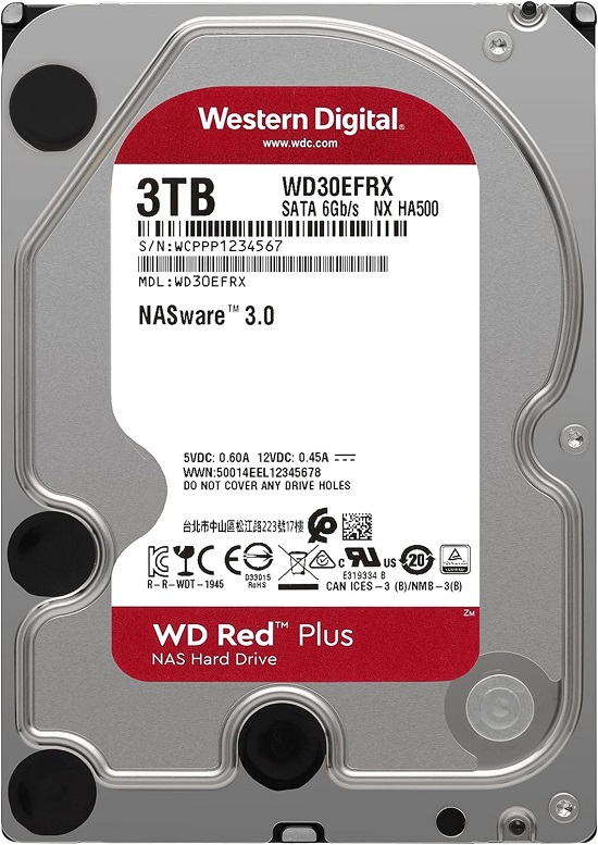

The hardware design of an Air Drive will differ from a Helium Drive.
The label on the drive can vary from HGST, Western Digital or WD (UltraStar, Gold, Red Pro, Purple Pro, White Label).
Air Drive Hardware Design Helium Drive Hardware Design
